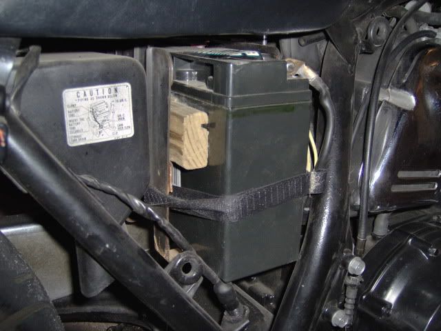

CB750-1100 battery boxes won't normally handle more than the regular 14Ah ETX15L type battery that fits them. If you take the door off and make a strap to hold the battery, or modify the door shape significantly, and alter the battery wires a bit you can get one of the 18 ah batteries to fit. Certain 1/2 U AGM wheelchair batteries can work in a rearranged fitment as well, they are also 18Ah, and can be bought for about $35. They aren't actually rated for motorcycle use, but will run the hell out of the starter and other facilities on a bike quite well. One guy has one strapped in with the door removed, under the side cover.
I suppose a better installation could be done, but that is a big battery!
One clever biker wrote:
I run a AGM Half U1 , 18AH . About $37 at my door . Ebay .
The battery box 'gate' was rusted beyond use when I bought the pile of junk , for $40 , that's now my bike .
I cut the gate off and use a Velcro strap to secure the battery . It's a bit longer and narrower than the stock battery , but fits inside the side cover without a problem . I also have to use a high class southern yellow pine spacer which renders the battery immovable .
The battery is currently in it's 3rd year of use with no sign of failure . I do disconnect the cables during the winter .
I think he sold that $40 umm... asset, after a few years of improving and riding it, for a substantial profit. Very Happy
