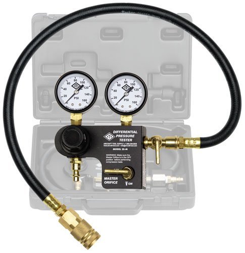

Leakdown testers are an odd deal. There's no [automotive] standard for their construction, and the calibrated orifice between the two gauges makes as much difference in the indicated leakage as the actual leakage does.
I have a Snap-On single-gauge leakdown tester that I've used forever. It is extremely sensitive. Brand-new automotive engines show 20--40 percent leakage. Ten percent leakage is unusually good with this tester.
A few years ago, I discovered that the (U. S.) Federal Aviation Administration has specs for leakdown testers, based on bore size. A tester for engines with bores smaller than 5" is to use a certain orifice size, and a tester for engines with larger bores uses a larger orifice. This is at least a standard for comparison, but may not be optimum given the small bores of the typical motorcycle.
I also discovered that Continental aircraft engines are supposed to use a leakdown tester having a "Master orifice", it allows the leakdown tester to be standardized against a separate, calibrated leak with regard to ambient temperature and pressure.
I bought a leakdown tester suitable for Continental engines off of Amazon, current price is about $120. Claimed to be "Made in USA" but the gauges say Taiwan. As this is sold by an aircraft-specific vendor, you'll need to tell them you don't want the 18mm spark plug adapter, you'd prefer 14mm, or smaller as the case may be.
http://www.amazon.com/Aircraft-Tool-Supply-Differential-Pressure/dp/B005VR9H24?ie=UTF8&keywords=Continental%20leakdown%20tester&qid=1460696591&ref_=sr_1_fkmr0_1&sr=8-1-fkmr0
