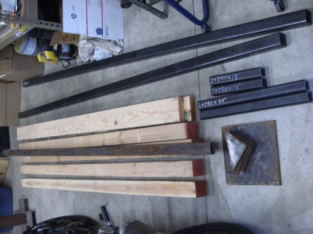

Well while I'm still waiting for new spindle bearings for my mil. I decided it was time to remodel the shop and pick up the material for the frame jig.
Since I got the CNC mill my shop has been terrible to move around in plus getting another parts mill tomorrow. Will combine the two old Bridgeports and make an ugly but functional mill out of them.
Heres the start of the frame jig.
Planning on making a solid wood bench and bolting the steel to it. Then get some caster's to be able to move it for storage.
That's all I got for now.
