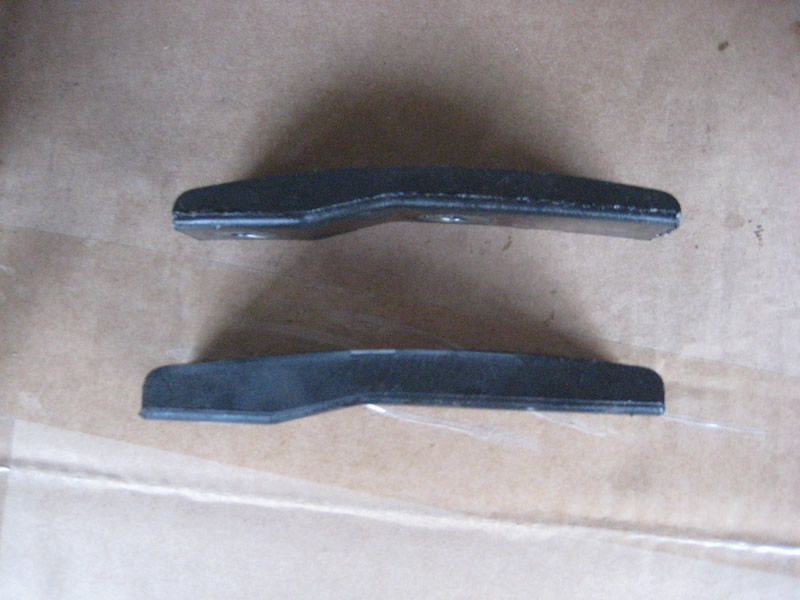

The lower primary chain tensioner was worn down to the metal (on the edges) :S which I am guessing "could" have had something to do wit the original knocking noise I discovered when I first got the bike started as the primary chain also seemed a bit slack when I first opened the engine casings ??? in any case a new chain and tensioners have been purchased.
I fitted both the primary chain tensioners (upper and lower) to the enigine casings as one of the first jobs before the re-build:
and out
onto the top tensioner
The wear on the top tensioner was not as extreme as on the bottom, however you can see the difference:

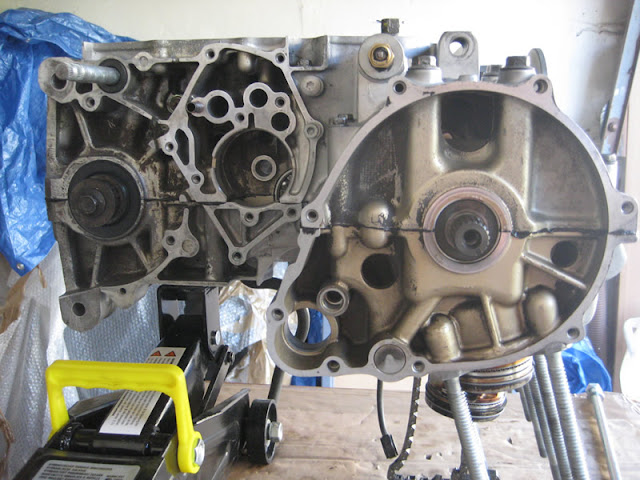

In the meantime, yet another clear up ready for the re-build. I know I keep going on about it, however I personally find that making some (although in my case limited) space and getting everything (tools and new parts) in place and accessible really helps speed up the process and also reduces frustration and mistakes. Saying that, I am also aware of some amazing projects that have come out of the smallest and most unorganised sheds Very Happy
Bootom end engine parts waiting on the shelf for new parts:
Engine cases ready for re-assembly:

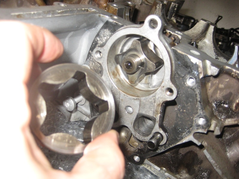

I have bought a new primary chain as I was not sure as to what condition it was in (im guessing bad) and I dont have the correct equipment to test / measure it correctly. Therefore I thought (like with most other parts im unsure of) to go new. Next was to check the primary shaft assembly. I have bought new bearings for the shaft, but wanted to check that the rubbers within the shock absorver bady were good, as if not I guess they could make for a "snathcy" feel between the clutch and gearbox during riding....
Ready for dismantling and inspection:
The rubbers looked (surprisingly) good. After taking them all out and inspecting them, none of them seemed damaged, and when assembled, they were tight with no free play. back together again Smile
New bearings and seals for the shaft:
and back together

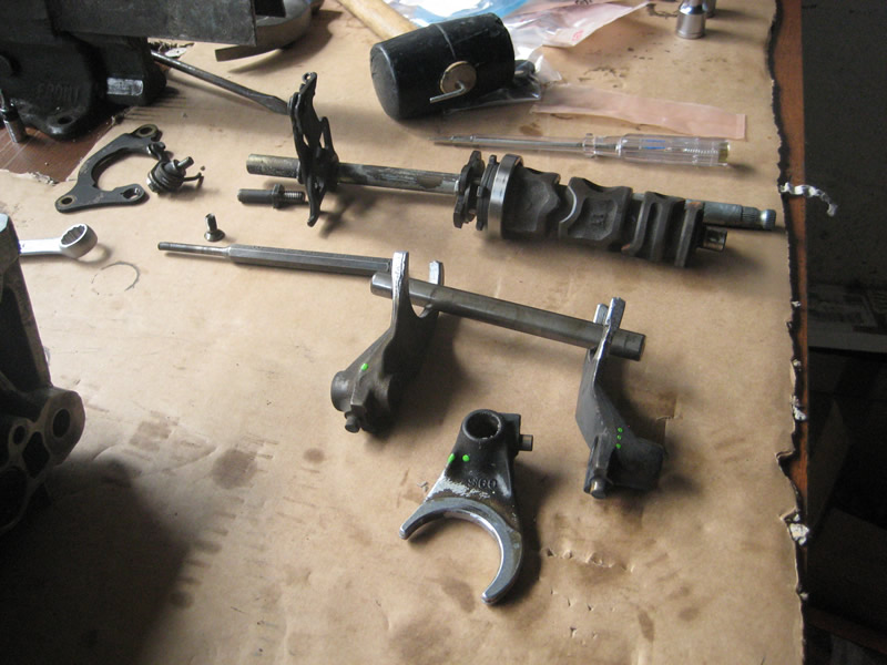

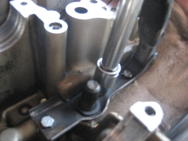

Next up, gearbox...
I stripped the gearbox shaft (my camera ran out of battery at this point so missing some pics), again replacing worn bearing and seals. I checked each gear for damage, but all looked great !!!
One thing I had not done was to remove the gear change / selector mechanism. I was not going to do so, as I thought I could just leave it in peace and place without disturbing anything, however I had both a new oil seal, and main bearing for the change drum, so had to take (most of) it out after all... Plus it was in need of a good clean.
My make shift parts wash:
and out:
Once out, I gave it all a good clean, fittend the new bearing, seal and also return spring (as mine was looking a little old) and re-fitted the mechanism which went a lot easier than expected.

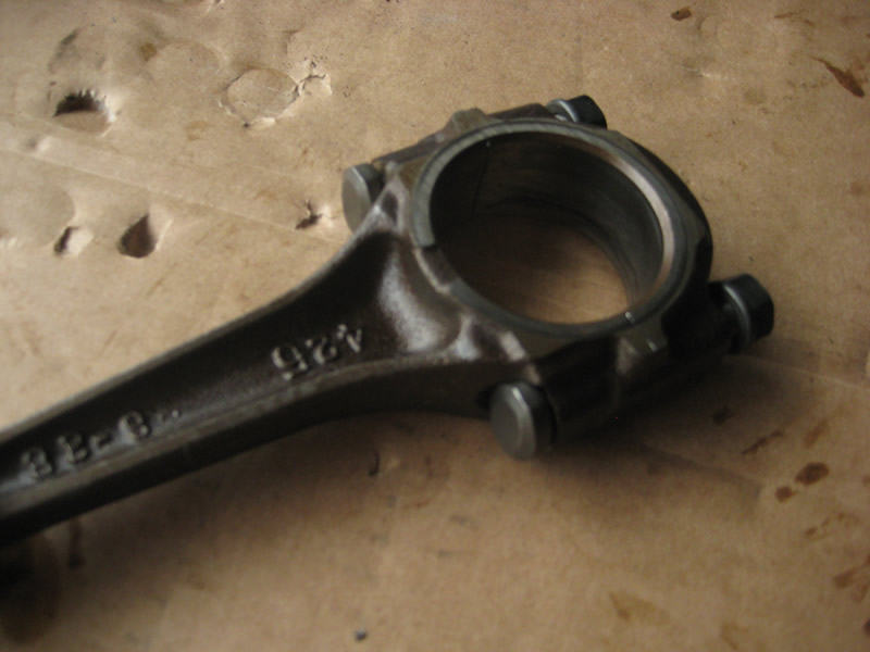

I had a little time between jobs, so decided to prep the connecting rods the new (green) bearing shells and new connecting rod nuts and bolts Smile (see earlier posts re checking and getting the correct (color / width) connecting and main bearing shells).
old parts:
new nuts and bolts:
and bearing (left) :
fitted:

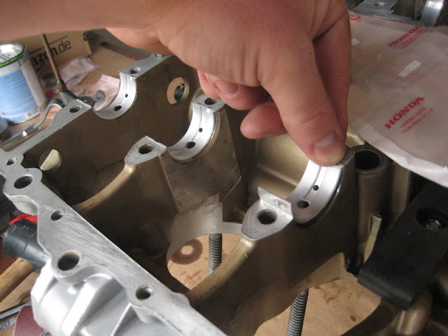

Next step.. more cleaning Smile I pretty much cleaned all parts before reassemble of the bottom end, e.g. cleaning the crank shaft :
After all new parts had been fittet to their relevant components, and all major parts and components were all cleaned up, I started the reassembly.
First up was to bit the new main bearing shells (brown) to both engine casings (I have already fitted the rod bearings):
Not forgetting to add a bit of oil to the casings before putting the shells in place:
Top half complete:
Onto the bottom half:
And the bottom casing bearing shells fitted:

Once all the bearing shells were in place and the engine casings were all prepared, the next step was to out all the internals (gear box, primary shaft, crankshaft etc ... ) back in.
This process went very quickly and very easily... I was (for some reason) expecting it to be a lot more difficult and time consuming than it actually was.
After all internals have been re-added, complete with new primary and cam chains:

Because I am not very prepared, I did not have any sealant to put between the two engine casing halves, and because it was a Sunday and everything over here is closed on a Sunday I had to wrap the motor up in plastic sheets to keep it clean and protect it until I could get hold of some sealant (hopefully the following day).

I also took apart, inspected and cleaned up the oil pump:
Which was all good, however that gasket was the hardest I have had to remove so far Sad

First off I put the gear box into 1st gear, and manually aligned the gear selector up to fit. I then applied the sealant to the correct surface areas of the two engine casings before putting them together. once together I torqued all the casing bolts up to thew correct torques settings.
