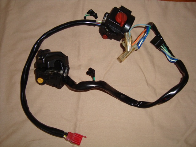

...as well as the switches:

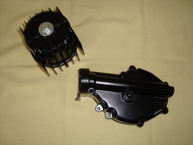

Here is the starter motor cover, fork brace and front brake splitter:

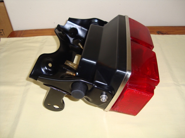

Tail light section:
Oil pump cover and oil filter housing:

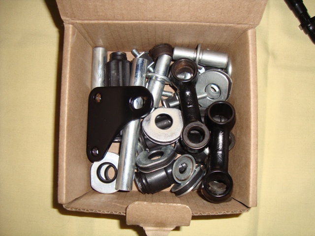

Engine mountings. This is going to be a challenge to put together as I have never worked on a rubber mounted motor before. Anyway, I plated all the steel parts of the mounts as they were quite badly rusted:

John,I see on the foto that you have done the enginemountingrubbers also.I never thought to do that,but why not!
So thanks for sharing.

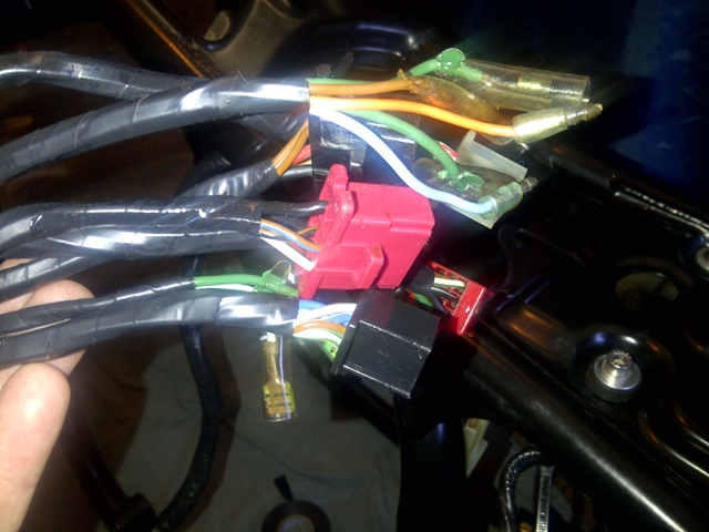

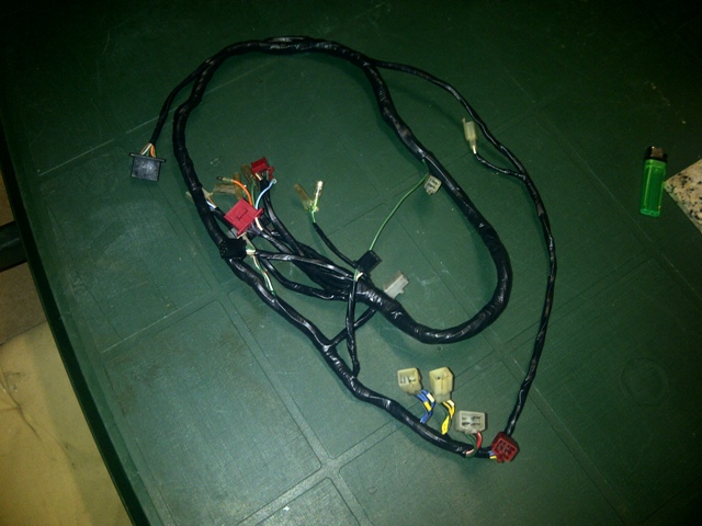

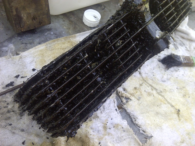

Wiring loom after a clean up and retape. I soaked the loom in a water based degreaser for a week and everything came out like new:

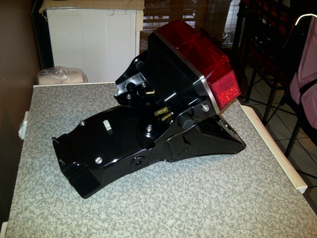

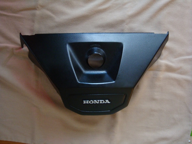

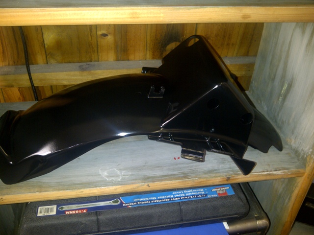

Here is the rear fender with the tail light mounted on it:
The rear mudguard. I had some problems with fisheying when painting these plastic parts. I wiped down the entire plastic surface with lacquer thinners and then resprayed. Worked beautifully. I used plastic paint from Rustoleum (a US product, and the same product I used on my 750F).
More to come...

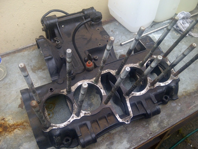

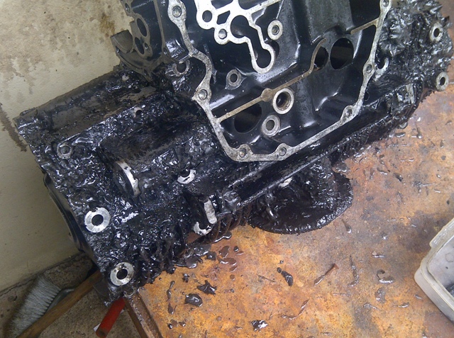

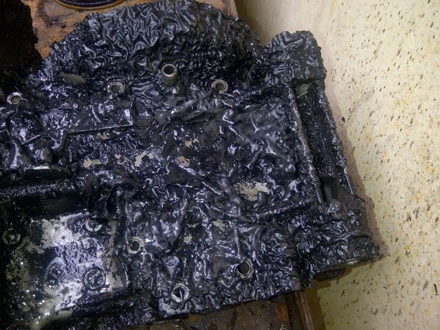

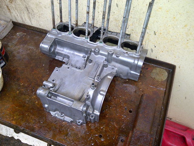

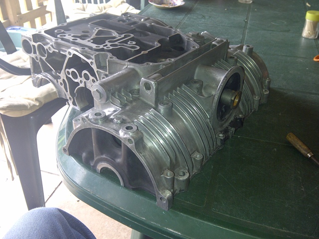

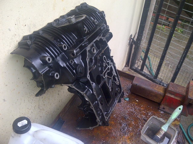

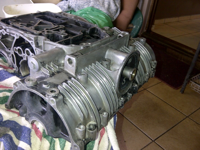

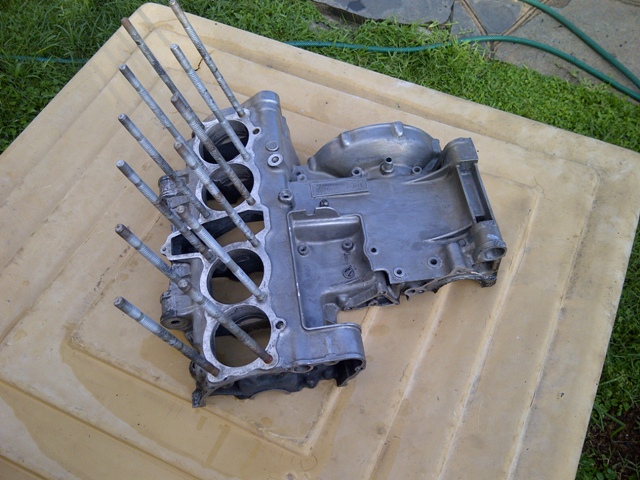

Stripping the engine cases was a filthy job and was labour intensive. The reason for this is I used conventional paint stripper and a high pressure water cleaner, as opposed to blasting it. Call it paranoia, I am scared that grit will get into the motor that I won't be able to get out. Here is the top case progress:
Here is the lower crankcase progress:
Yes, I am going to powder coat these.

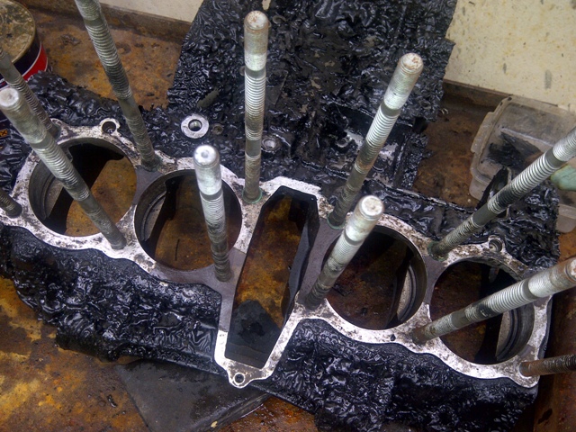

I also stripped the block with paint stripper and high pressure water:

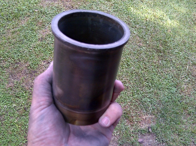

Before stripping the block, I removed the sleeves. Removing the sleeves is easy. Heat up the block on a stove and the sleeves practically fall out. There are a lot of fins that need welding up. I will try this myself.

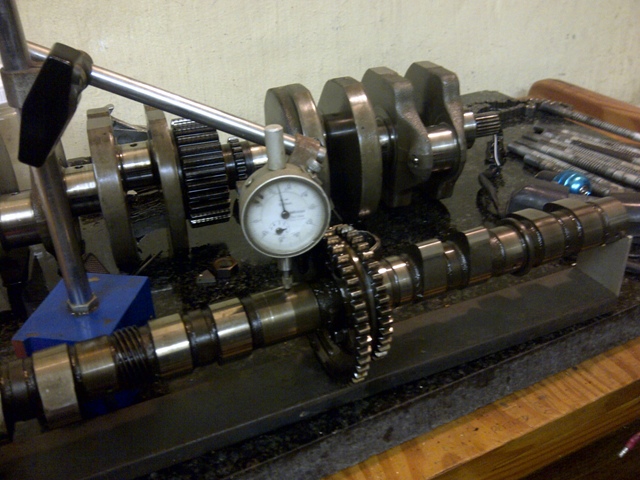

Checking straightness of cams. Not really going to help, both camshafts I have are so worn, but I will have to use them until I can get them built up.

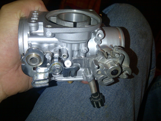

Here is one of the carb's I have done. The bank is complete and I will be posting some pics soon.

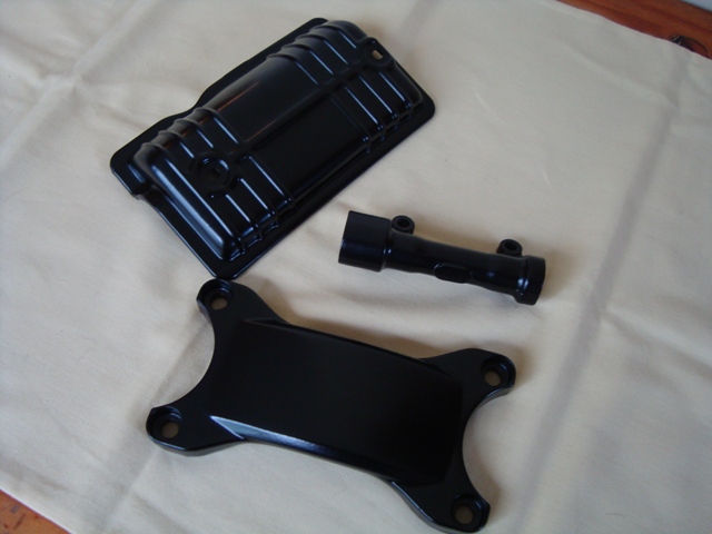

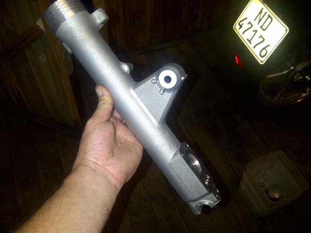

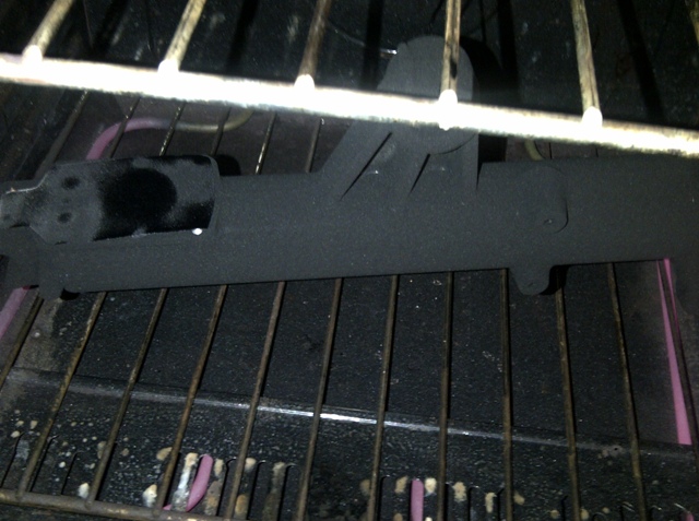

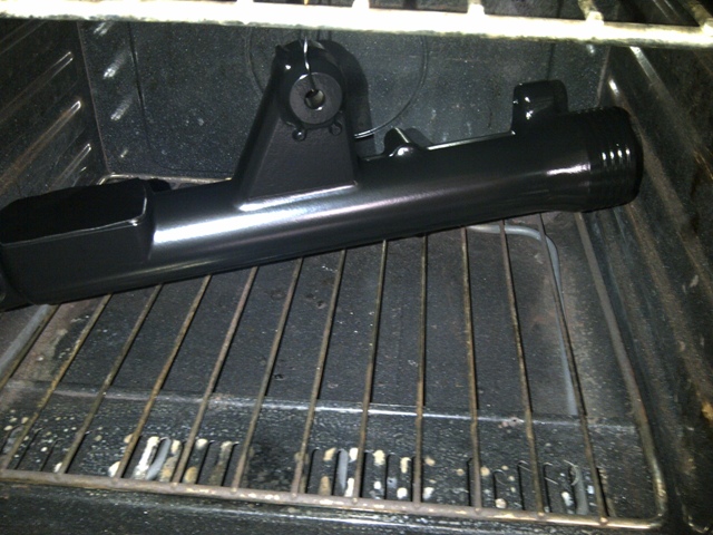

Here are the fork bottoms. I blasted them with Al-Oxide and then powdered them with Jet Black powder in my new (old) big oven I got from a colleague. The biggest items that I have powdered thus far.
Blasted:
Powdered:
Curing and Looking Good!!! Amazing stuff.
I am thinking of redoing my 750F front forks with powder as the paint is very very chipped.

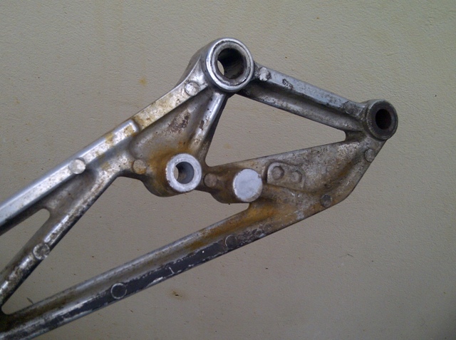

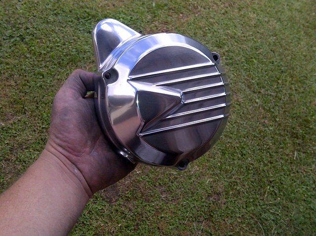

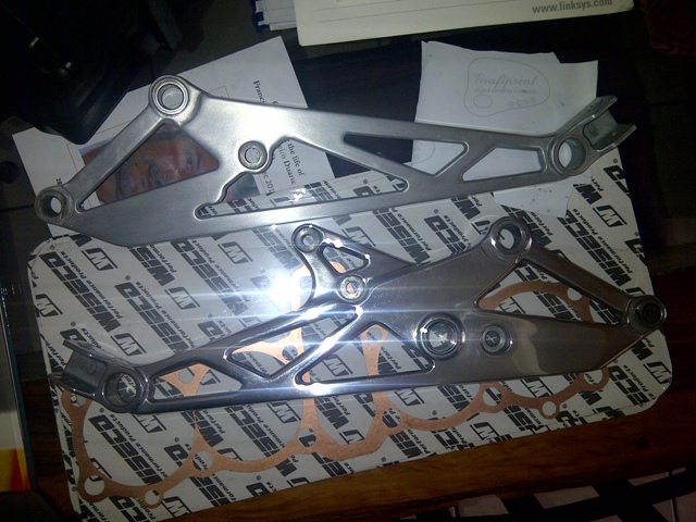

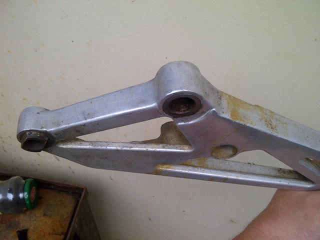

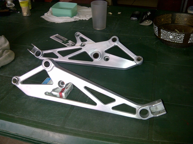

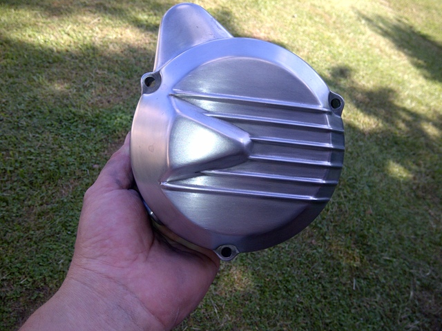

Polishing the aluminium bits is my favourite part (NOT!!!). I used the same procedure that I did on my 750F. It is fool proof and is guaranteed to work. I did all this in one day. It is VERY labour intensive and a VERY dirty job, but well worth the effort.
My procedure is as follows.
1. Clean the parts with a good degreaser
2. Remove all blemishes and sand the entire surface with 100grit
3. Repeat with 400grit
4. Repeat with 800grit
5. Repeat with 1,200grit until all previous sanding scratches are gone, and you get a nice even dull finish
6. Buff with a good metal polish.
Please note that all sanding is wet sanding.
Footpeg plates before:
After the sanding process is complete:
The bottom plate has been buffed. Some may prefer the matt look above?
I will not be looking for lattice rearsets (they are quite popular here in SA), I am going to try riding with my feet in the more forward position. It may be more comfortable for me on longer rides. My 750F with rearsets just causes cramp for me on distances over 300Km's. Maybe I am just getting old.
Rotor/Alternator Cover:
After the sanding process:
During:
After:

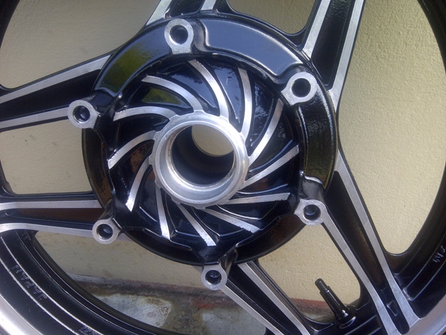

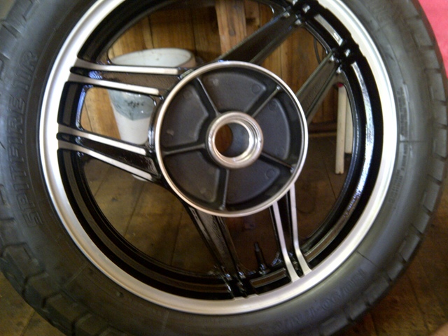

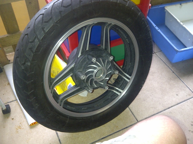

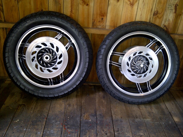

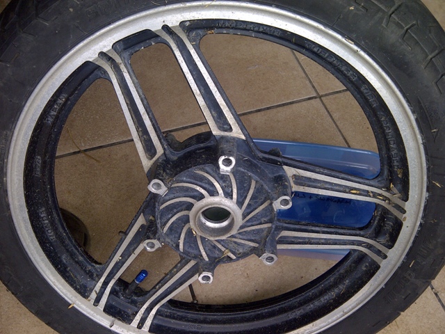

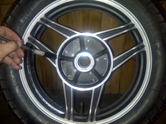

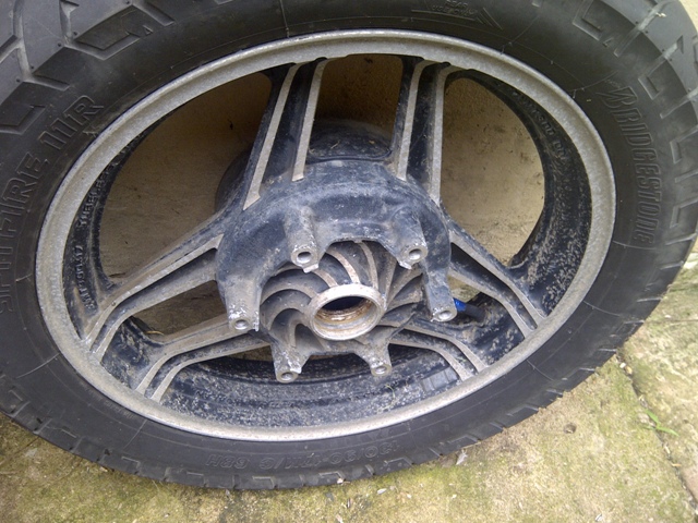

The wheels were a PITA, but I was very happy with the results. I replaced all bearings and seals and chose to paint the rims with a (shinier than usual) satin black vs powder. I was lucky that the tyres were still in good condition (Bridgestone Spitfire 11R's).
Here is the front rim before:
I rubbed the old coating down with water paper and cleaned the rim with lacquer thinners. Once coated with paint, I rubbed all the high spots off before the paint hardened, much easier than masking I thought. Much of a muchness. Rubbing off the high spots was a Bitch with a capital B.
All high spots off:
Rear wheel I followed the same procedure:
Both wheels done. Discs got new paint too.
Thanks for looking - I will post some more pics soon.

I hate getting to the bottom of one of John's pages only to find "that's it" for the time being with the pictures!!! Twisted Evil
I'm just starting my 1100R rebuild and I'm interested in how you managed that wiring loom. Does the degreaser make the tape unravel? Or do you have to remove the tape and cable tie the various bunches together?

Thanks very much for all the comments guys, yes I am a pedantic pain in the arse - I got it from my dad Rolling Eyes
Andy you hit the nail on the head, that is exactly how I do the loom. Unravelling old tape is near impossible, so I run a small pair of scissors down the loom (obviously being careful that I don't cut wire), and cut the old shit off. As I get to a bunch of wires that branch off, I cable tie them together at the stem, against the main wad of wire. That ensures the shape of the loom.
The solution I use is called Prepsol. It is a non-solvent water soluble degreaser that can be diluted to say 50:50. I use it neat to soak the loom in (a week is too long, a day will suffice - just that I forgot about mine). It even removes all the sticky stuff left by the old tape, and cleans the connector blocks and the connectors themselves. Being non solvent means it will not attack plastic etc. Once soaked, rinse in water and then blow the connector blocks out with compressed air. It will look brand new afterwards. Let the loom air dry and then retape. Use a good thick electrical tape. The front section can be a little tricky where all the branches come out.
Please start a thread on your R rebuild. I was going to buy an RC, but have my eye on a clean GS1000G. this weekend.
Edit: I also clean my switches as per above. I am pretty sure the results are close to ultrasonic.
