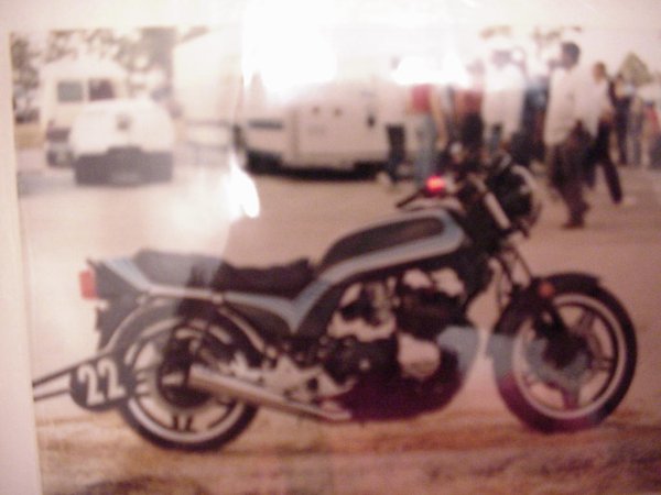

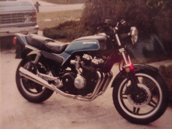

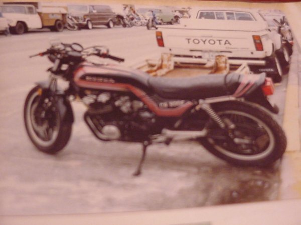

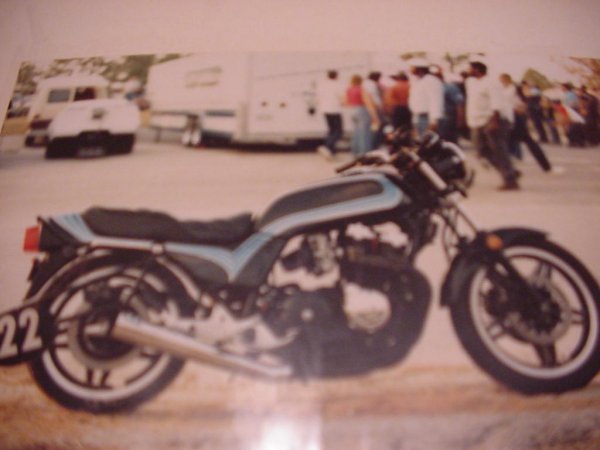

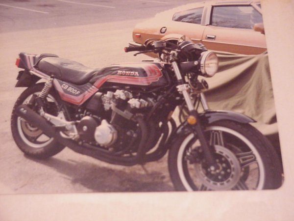

    Here are some pics for the website, as I said before these are pics of pics so they are not of good quality. The Black w/ red stripes and the black w/ blue are the same bike just different paint jobs. This is a 1982 CB900F that is 985cc (Wiesco pistons, Andrews cams). It has 33mm Mikuni carbs and ran 11:20's @ 115mph in street trim.

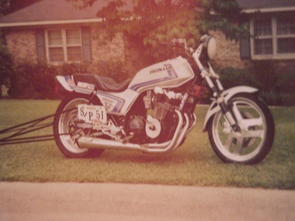

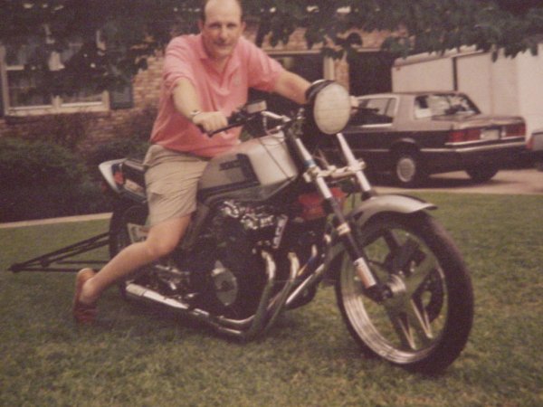

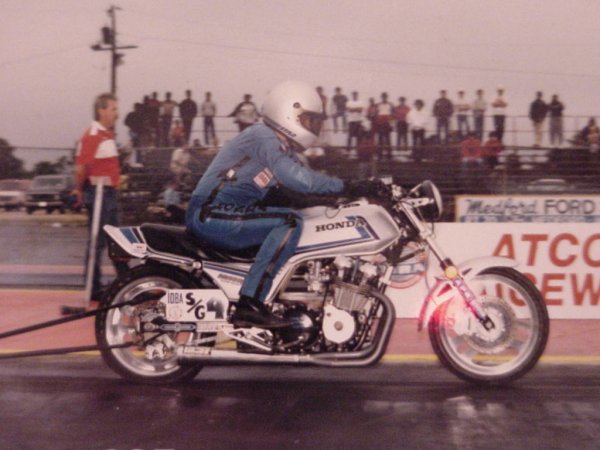

    The Silver and blue Drag bike was all out. It's 1155cc, Andrews cams, titanium valves and retainers, Carillo steel rods. The head was ported by Ferracci and the engine assembled by John Sands Racing (worlds Fastest Honda). A stock frame with a 4" over Kosman swingarm and a 3" rake, with PM wheels and brakes. The mixture came from Lectron carbs and was fired by a MSD ignition.
    This bike was the IDBA (International Drag Bike Assoc.) number 4, 10, 3 plate holder for Super Gas in 1986, 1987, 1988. It had a best quarter mile time of 9.61 @ 141mph.
