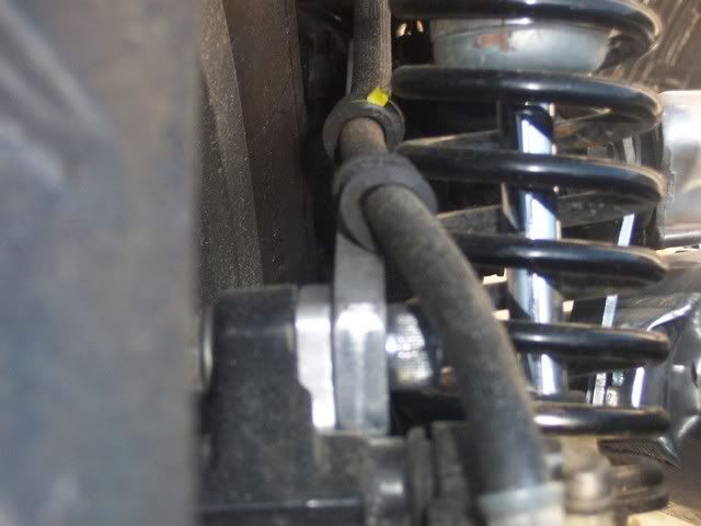

I removed the wheels on my CB1100F and had an Avon Azaro AV46 140/80-17 rear tire mounted as well as an Avon Storm 2 Ultra 110/80/18 front tire mounted.
Here are a couple pics of them installed.
I road with them for almost 300 miles this past weekend and all I can say is wow!! The bike has never handled better and corners nicely with this combination.
I'm not a knee dragger but they seemed to have a lot of grip. Don't let anyone tell you not to try radial tires on your old Honda Laughing

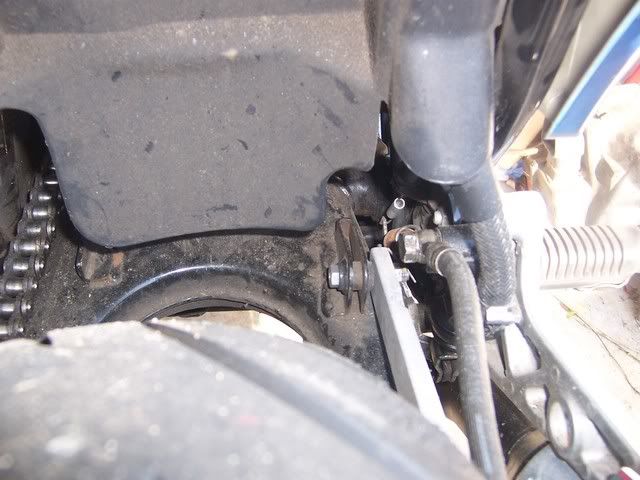

I'm curious, did you have to bend the rear torque link to get them on?
I just installed a 130/90 Shinko Tour Master on the rear and there's no way a 140 would have gone on without some bending. I think that Sono has pointed out many time that the way tires are measured is not the same between MFR's.
No modifications were necessary. There is about 1/8 inch between the tire and the torque arm.

Here is a pic of them on the bike during the trip to give size perspective. Its hard to tell from the crappy pic but they look "right" on the bike.
The size difference from stock is not noticable.

As for the rear brake stay arm, I use a 3/4" x 3/8" aluminum bar and bolt it on the outside of mount. This clears my 160/60ZR18.
